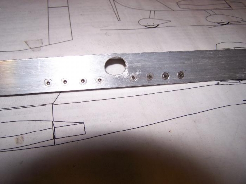

Add Longeron Doubler Plates
Located and pilot-drilled doubler plates on left and right longerons. These need to be offset to the front to allow the windshield bow to lay forward of centerline.
Up-drilled, deburred, countersunk, and riveted with CCC-44 rivets.
