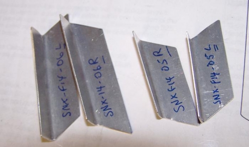

Fabricated SNX-F14-05 & -06 left/right upper and lower firewall attach angles. Ripped raw strength to correct widths and cut 30 degree angles on the end of each piece.

Upper & Lower Firewall Attach Angles
