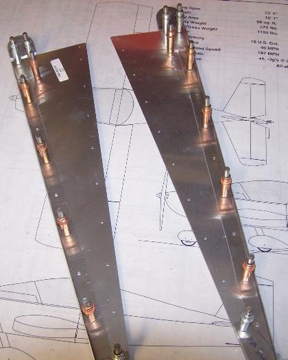

Seat Belt Attach Webs
Cut Z02-03 2x2 angle down to ~3/4" x 20+ inches. Cut relief radius and angles.
Bent seat belt attach stock (3/16") up about 10 degrees.
Drilled & cleco'd. Up-drilled to #30. Disassembled, deburred, and re-cleco'd in preparation for riveting. This completes SNX-F23-05L / -05R.
