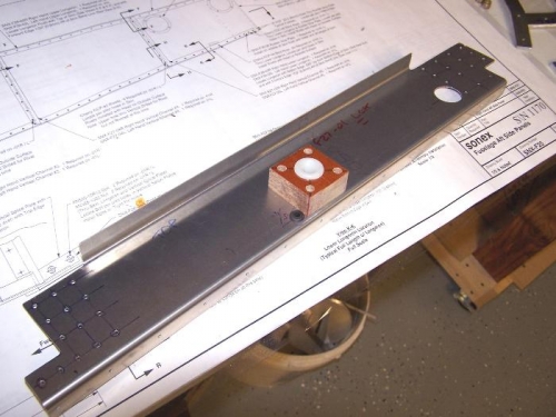

Disassembled left aft fuse panel. Deburred all parts, re-cleco'd together in preparation for riveting.
Positioned and drilled fairlead blocks to SNX-F27-01 & -05. Riveted using CCP-46 rivets.

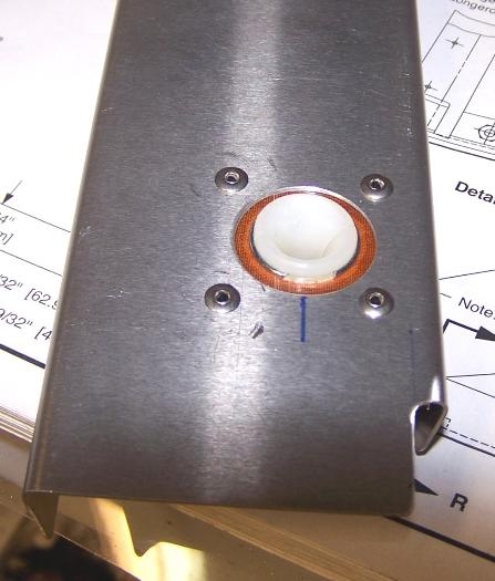

SNX-F27-05, riveted fairlead

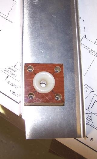

SNX-F27-05, backside
SNX-F27-01 Riveted Fairlead
