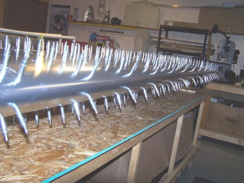

Bottom side of Left Wing Leading Edge Cleco
Removed cleco's from main spar. Using ratchet straps, pulled the skin down into position and cleco'd to the main spar.
Pilot drilled all forward ribs, lower side.
