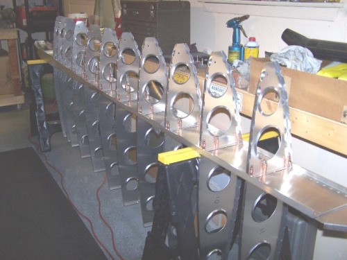

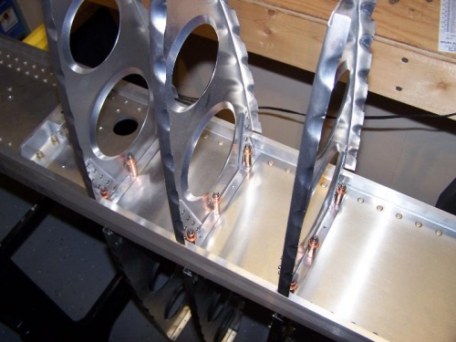

Left Root Rib Rivet & Up-Drilling Ribs
Riveted Fwd / Aft left wing root ribs to attach angles.
Up-drilled fwd/aft left wing ribs to #30 thru main spar.
Next steps: Remove ribs, deburr all. Deburr main spar. Bolt root rib halfs to main spar, rivet ribs to main spar, then rivet aft spar to ribs.
Riveted Root Ribs
Ribs Up-Drilled to #30
Overall Shot of Up-Drilled Ribs
