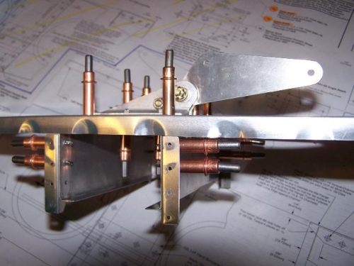

Brief Description: Left Ailieron Bellcrank / Rib #9 Ready to Rivet
Basically ready to rivet the left #9 rib / aileron bellcrank subassembly. Tonight, worked with #1 son to position the skin attachment clips, pilot drill them, then up-drill all parts to #30.
Deburred all parts and re-assembled in preparation for riveting.
