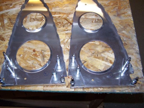

Left Wing Rib 1 & 4 Rework
Drilled 1/4" radius holes in each of the ribs; trimmed flange material away as per plans to clear the main spar caps.
Deburred.
Positioned, drilled, and cleco'd all 4 rib gussets.
Next up: up-drill to #30, deburr, and rivet gussets to ribs.
This will complete the rib rework.
