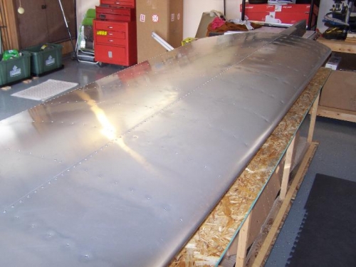

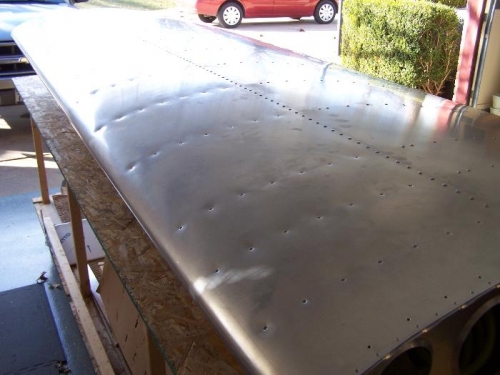

Brief Description: Completed Right Wing Box (mostly)
Finished riveting the leading edge skin today. Had done the lower LE skin yesterday, and had it all in position for today.
Completed riveting. Had a few issues where I had to manually finish a few rivets (the pneumatic riveter started the pull, then snapped off the rivet stem leaving a short stub). Manual riveter gripped these stubbs just fine and completed the pull.
