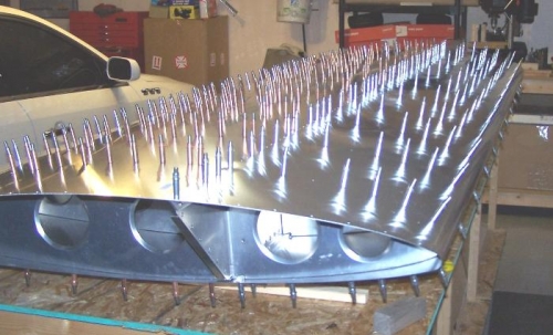

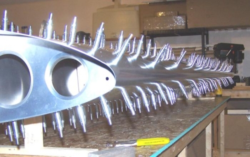

Brief Description: Right Leading Edge Pilot Drilling
With my neighbor / CFI's help, flipped the wing back over right side up. Drilled the final 2 rib holes on each rib and cleco'd.
Still have to locate / pilot drill the flap and aileron hinges, fabricate and locate the pitot/static probe support (next to #5 rib), fit the fiberglass wing tip, dimple the leading edge rivets, and other finish up stuff. Will probably do the initial fitting of the aileron control rods, as lots of folks have commented about the poor access thru the inspection hole on the lower side of the wing.
