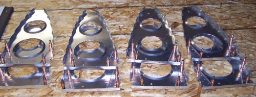

Positioned and drilled all 8 forward ribs that required additional gussets (ribs 1 thru 4, each side).
Drilled to #40, then up-drilled to #30.
Tomorrow just have to debur the gussets and ribs and then rivet them (CCP-42's).
4 pair of forward ribs
