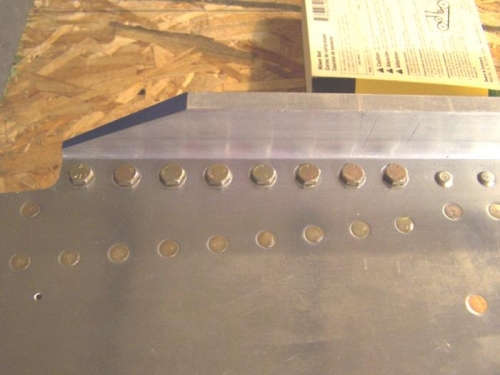

Continued with SNX-w08, Main Spars (L/R).
Installed 16 AN3-7As (8 each spar) on lower edge of inner spar as per plans.

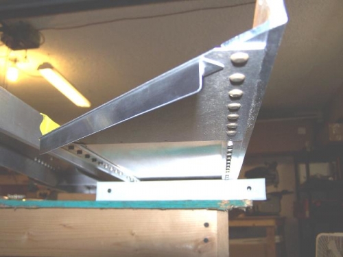

Fabricated SNX-W10-06 tip attach angles (2). test fit to spar, drilled as per pilot holes in SNX-W10-07 (part of prebuilt spar), then riveted with CCP-42's.

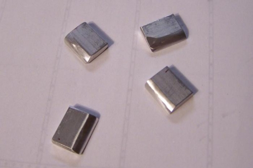

Fabricated all 4 radius blocks by cutting to length and radiusing them to fit the pre-fab'd SNX-W13-02 (L/R) root rib attach brackets that are part of the machined angle components kit.

AN3-7A's 8 per spar
wing tip attach angles, installed
Radius Blocks; 1/2" x 5/8"
