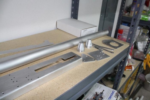

Brief Description:  Drill, Debur, and Prime Trim Mount Bracket Assy
Step 1: F-1095C Trim Bellcrank Brackets provided by Full Throttle Concepts.
Step 2: F-1095G Trim Cable Anchor Brackets provided by Full Throttle Concepts.
Step 3: Fit Trim Servo Spacer to underside of Trim Mount Bracket
Step 4: Cleco Trim Servo Spacer to Trim Mount Bracket by four corners. Cleco Trim Bellcrank Brackets into place. Match-Drill #30 hole of trim bellcrank brackets and trim cable anchor brackets
Step 5: Cleco Trim Cable Anchor Brackets in place an Final-Drill #28 in the four corner holes. Machine countersink eight #30 holes in the trin servo spacer for 426AD4 rivets.
Step 6: Run #40 drill through the eight #40 holse in the trim mount bracket for 426AD3 rivets. Run a #30 reamer through close-out corner flanges in the trim mount bracket.

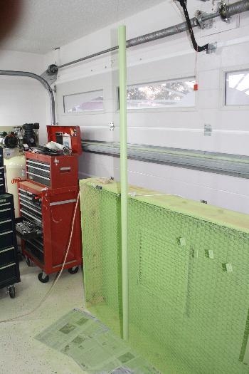

Step 7: Debur all holes and edges of all assembly parts including any left over Tail Cone parts. Prime all including elevator pushrod tube and related ends.
Deburred and ready for primer

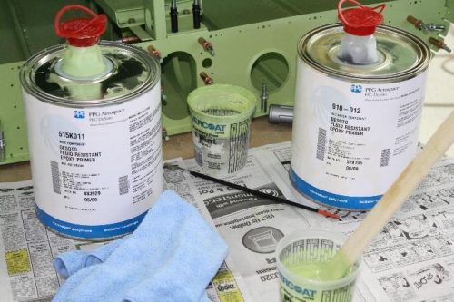

Mixed, waiting 30 min induction time
Primed including inside of pushrod
