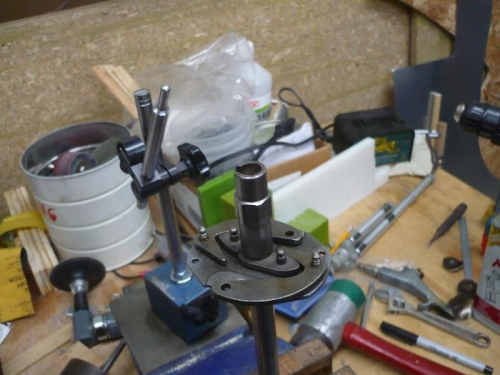

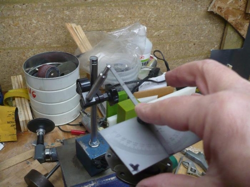

Using a bump stop, check actual degree of movement of the distributor rotor with a protractor.

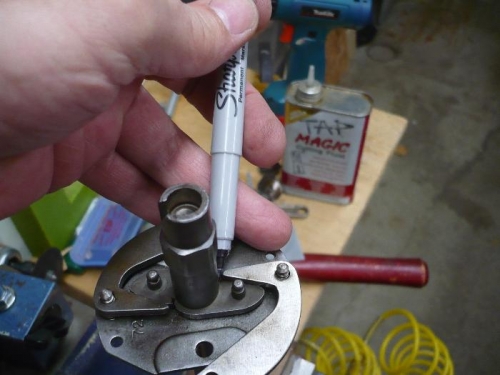

Then mark the rotor plate for notch.
Next find out outer limit of weight movement.
Bump Stop Mag Base
Protractor 11-12 degrees
Mark rotor plate for notch
