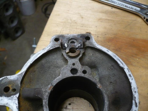

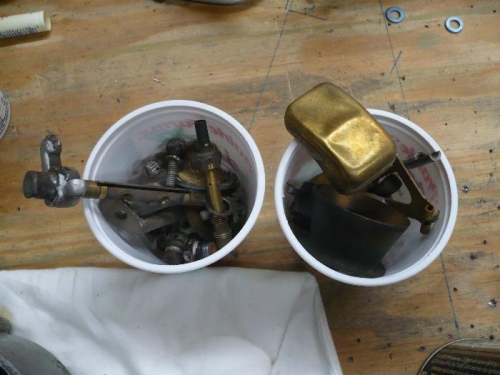

Brief Description:  Finish stripping down carb

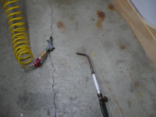

The screws holding the float pivot were soldered over and connected to the float jet body. I used an acetelyne torch and compressed air to release the solder and turn the screws out.
The float jet body might need a special tool to get it out of there.
