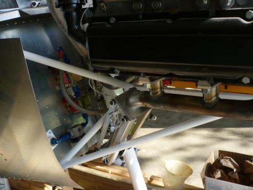

Now the manifold is removed and the exhaust pipe is placed in position to transfer the cut line to it.
Cut the pipe to the line and test fit to the manifold and mark for tacking on the bench.

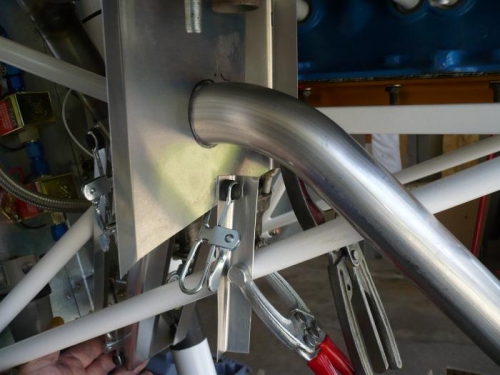

I broke the tacks and rotated the fit up .06" to provide better clearance.
Pipe through plane
Draw line around pipe

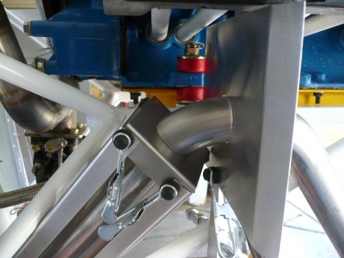

Tacked in position
