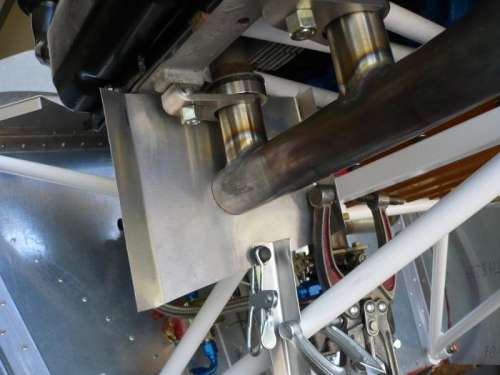

Fabricate right exhaust pipe & heat muff 2 of 4

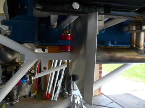

Cut the manifold .5" from the stub to establish the cut plane.
Clamped a piece of sheet metal to the engine mount, flush the end of the manifold.
The cut plane will get removed and replaced several times here so it is important to mark it so it can be relocated exactly where it was.

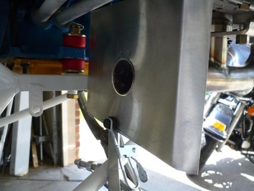

Transfer outling of manifold onto the cut plane, and cut it out.
Establish cut plane
other side of cut plane
exhaust manifold cut plane
