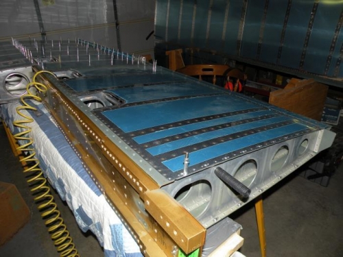

Brief Description:  Right Wing Bottom Inboard Skin
Today Karen and I riveted the left inboard bottom as far as we could go before moving the outboard skin so the overlap is on top. I had the outboard skin clecoed on to hold the skeleton square, and had it under the inboard one at the overlap so we could lift the end of the inboard skin for riveting access. Karen's getting the hang of riveting and ran the gun on close to half of these rivets!
Rivets Today: 198
Rivets Total: 8661
