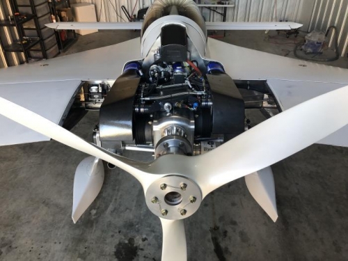

Brief Description:  Here comes the Catto
As you know I've gone through props like underwear. Knowing that I will be spending the majority of flying in and out of unknown airports long distances from home, I decided on going with the Catto 3 blade 60x76. The silver bullet is prop of choice for climb and racing down low, but for short strips and high altitude cruise, the Catto can't be beat. The Catto accelerates much better on the ground to reduce ground roll by 30% and allows a savings of .5gph in cruise, so knowing this, I've settled on the Catto for now. And she looks great with 3 blades :)
Catto 60x76 is back in action
