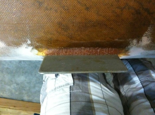

Number of Hours:  0.25
Manual Reference:  ch 7
Brief Description:  A better radius
I whipped up some flox and added it to the upper side of the step to give a less dramatic transition from fuse to step. I've seen some EZ's that have not done this and the extreme angle and hard-to-reach space makes it difficult to finish well and end up with an ugly finish in the end. After the Flox cures it will be sanded smooth and contoured....of course.
curing
