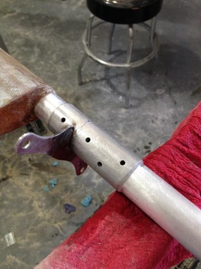

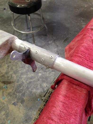

Early on in the build I had the idea that only 1 bolt on the elevator torque tube was high risk for failure and had the wise idea of adding rivets as well. Well in the last 2 years I've learned that BKB (Burt Knows Best) and adding safety features to an airplane that's proven itself over the last 35 plus years is a small waste of time. HOWEVER, now that there are holes in the torque tube I added the rivets anyway. In fact I wasn't pleased with the rivets I installed way back when so I removed all of them with a 1/8" bit and added new ones. I also was able to really clean off the torque tubes and get them ready for primer.

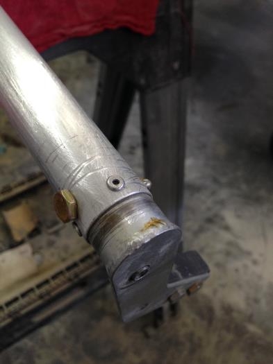

Now something showed up that I am VERY glad I found. The right elevator bell crank/ torque tube assembly did not have an AN3-12A bolt installed !! How could the previous builder miss this step?? Anyways, I used my step drill for very easy drilling of the SS and installed the bolt per plans.
drilled out old rivets
new rivets in
new rivets in
rivets added
rivets added
