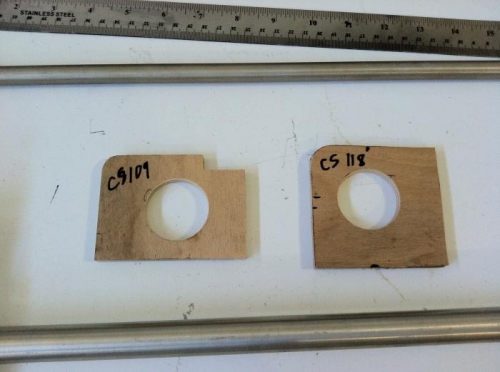

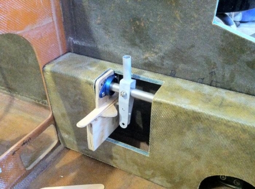

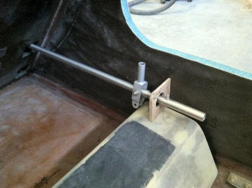

The pictures don't do justice for how precise the parts come from Cozy Girls. Absolute top notch work. They did however take some time to assemble. I drilled out the brackets in plywood and have now began trial fitting control system to the fuselage. The trickiest and most time consuming part about this is knowing exactly where to mount the bearing in the brackets. the stock controls are different, so the plans can't really be following here. Too far left and you get a bolt jabbing your right leg and too far right and you won't have sufficient right aileron input. Trial and error will make it work, but it will be just that...work :)
brackets
brackets
trial fit front
trial fit front
basic position for passenger
