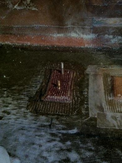

Brief Description:  Pitch trim glass and metal work

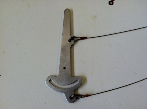

I floxed the pitch trim bolts and brackets to the fuselage as well as adding 1 layer BID on top per plans. I also floxed in the 2" nylaflow tubing for cable routing to the canard. While these cure I starting cutting springs and cable to length per plans and assembled them to the trim lever. After the cure I will assemble the whole unit and it will be ready to be attached to the canard.
Trim bracket and 1 layer BID
nylaflow tubing
nylaflow tubing
trim lever cables attached
