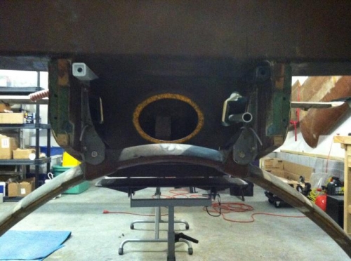

Brief Description:  Main gear bolts installed
For a few weeks the ez has been on it's gear with just the bolts temporarily in place. I've now run the bolts per plans, added locktite, and torqued to 190 in/lbs per spec. They were a tight fit so it took some time getting them to comply. All is well and with luck, I'll never put a wrench to them again :) And WOW, AN6-80A is a LONG bolt and at $30 a piece I'm glad they were included with the project.
