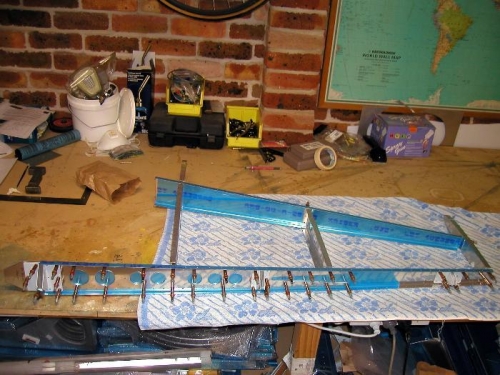

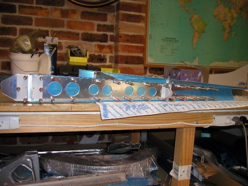

Today was a huge day as I started to assemble the Vertical Stabiliser, the first job is just to cleco everything together after edge finishing the doublers and spars, then the ribs get prepared by fluting and straitening, 2 hours later job done. The all the spars and ribs get final drilled out to #30.

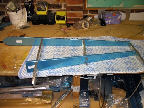

VS-808PP clecoed to VS-803PP and hinges also clecoed in place
