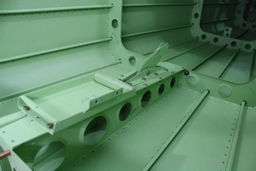

Went ahead and rivetted the Trim Cable Anchor Brackets w/ 426AD4-5 rivets
10-23
Step 4: Bolted Bellcrank Angles to Battery / Bellcrank Mount
Step 5 Attached Battery / Bellcrank Mount to Rib Angles in the Tail Cone.
10-24
Step 1: Install Battery Channel without Battery just to keep the parts together.
Step 2: Install bolt hardware in Battery / Bellcrank Mount without ES 24115 Master Relay that I do not have yet.
Step 3: Install Shoulder Harness Anchors to Tail Cone Longerons with the harware specified.. Torqued to 30 in-lbs and Torque Seal applied.
Tail Cone Complete.
