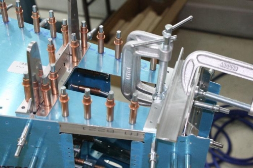

10-13 Step 1: Inspect manufactured Hz Stab Attachment Bar Support Angle. Step 2: Inspect manufactured Up Elevator Stop. Step 3: Match-drill four holes of F-1010A Spacer. Step 4: Match-drill side holes of Aft Deck. Step 5: Final-drill F-1011B Stop/Doubler holes. Step 6: Position and clamp Attachment Bar Support Angle to Attachment Bars. Step 7: Position and clamp Up Elevator Stop on Aft Deck.
