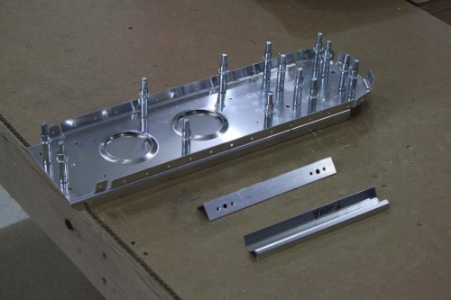

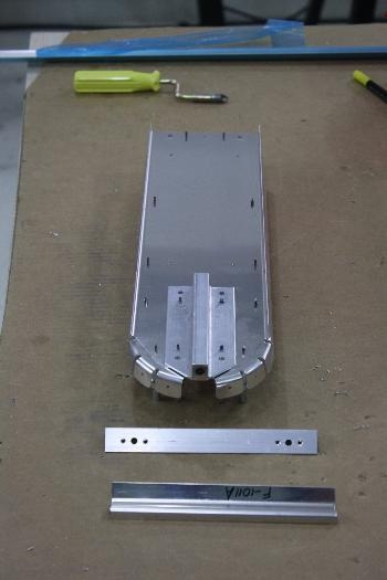

Brief Description:  Aft Bulkhead and Tie Down Bar
- Made the Tie Down Bar per the plans except I need to tap the end yet.
- Assembled and match drilled Tie Down Bar and Rear Bulkhead.
- Made the Rudder Cable Angle from the AA6 -063 3/4x3/4 material. Then I made it again after I goofed up the countersink depth. Again, unfamilar and a new countersink cage.
- Made Bulkhead Stiffener from J-channel,
- Deburred Rudder Cable Angle and Bulkhead Stiffener.
