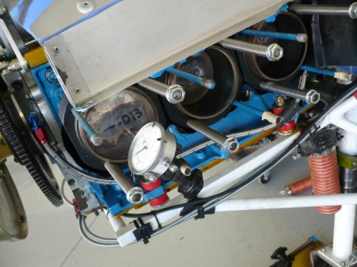

Cylinder deck height measure 1 of 2
Used dial indicator to bring piston to TDC then measured from top of cylinder to top of piston on all cylinders.
#1 -.014 #3 -.023 #5 -.020
#2 -.013 #4 -0.10 #6 -.013

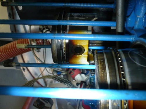

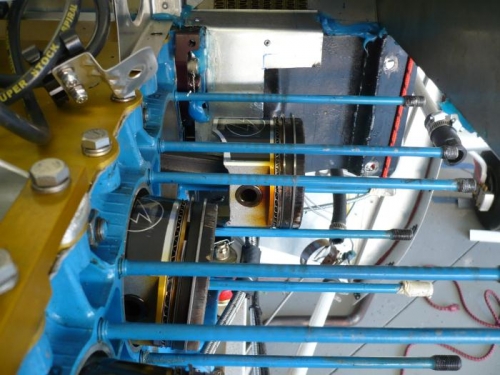

Pictures 2 and 3 show the discoloration on the pistons.
