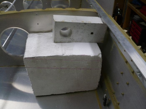

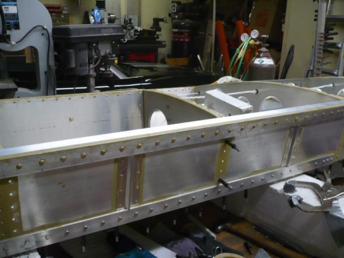

Solid Rivet main spar cap
Cut slight angle on 6" foam to rest the 5lb bucking bar on.
Taping each individual head helps hold the rivet in place, acts as a protective layer and visual signal when removed that the rivet is set properly.
Using a skip pattern keeps everything straighter
