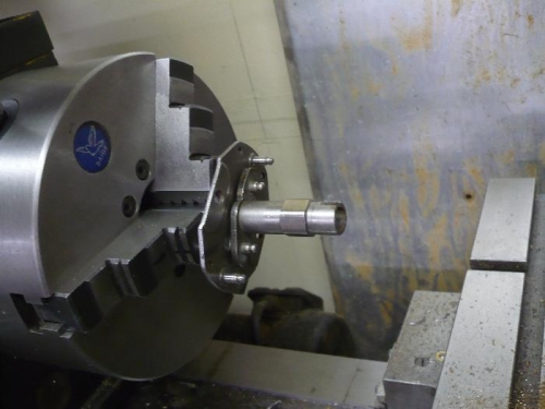

Turn down shaft to add bushing for rotor cam
Chucked up the distributor shaft and turned down the endso it can be bushed to take up the clearance.

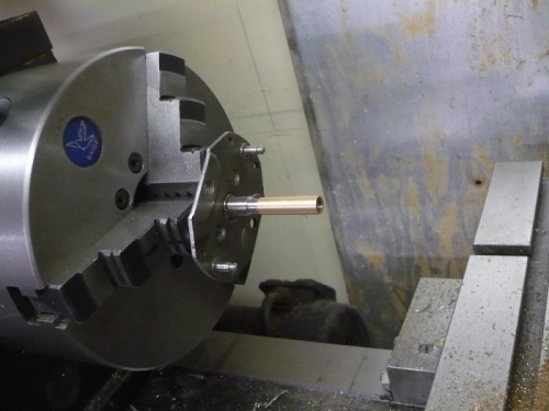

Drilled reamed and cut bushing material to press on the shaft.

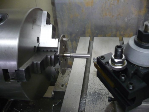

Turned down bushing on the shaft for proper clearance.
