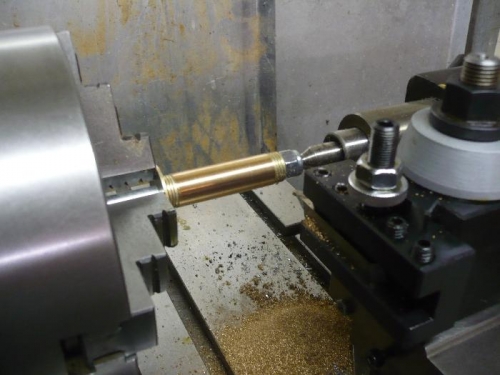

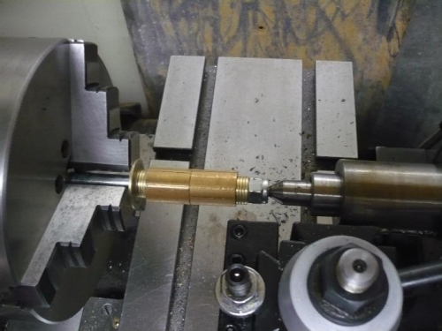

Machine OD of bushings
Made madrel out of the 3/8 bolt by facing, center drillining each end and setting it up between centers on the lathe.
Set spacers and snugged up nut to hold the two bushings still.
Machined to .654" od This will allow for .007 clean up cut on the distributor ID.
