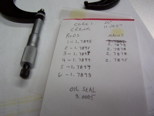

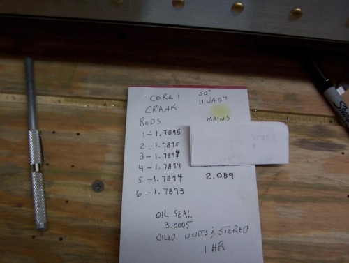

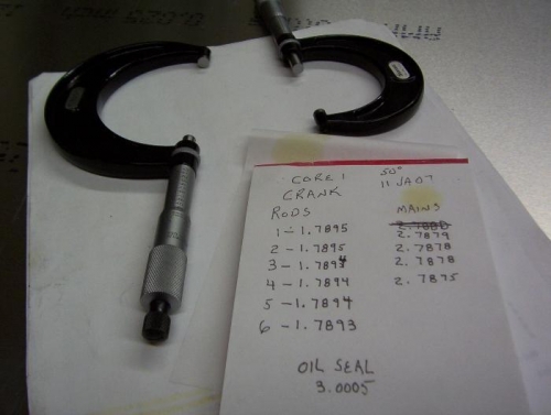

Checked crank with 1-2" and 2-3 inch micrometers. Guessed the tenths by comparision. The mics weren't incremented beyoud .001.
1.789 on the rods and 2.089 on the mains. No out of roundness detected with the mics.
Findings
Correction 2.089 mains
