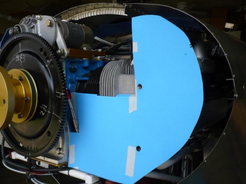

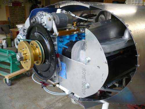

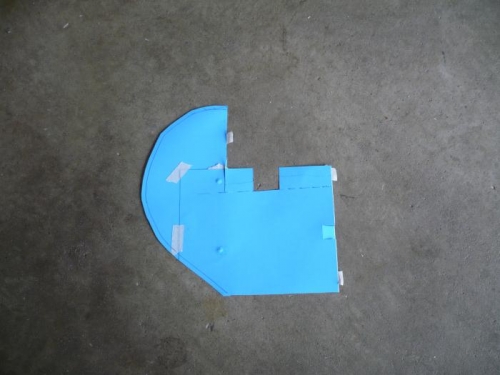

Left front Baffel
Start with an oversize paper template and trim and bend to shape. Outside is oversize.
Fitt nose bowl and trim paper closer.
Make out of metal and fit and trim to fit. The nose bowl was on and off many times and I reached in through the inlet and marked areas to trim.
One more piece then seals get fit.
