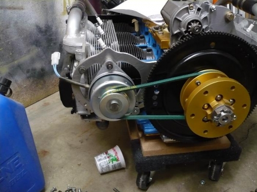

Brief Description:  Alternator bracket redesign for Kubota

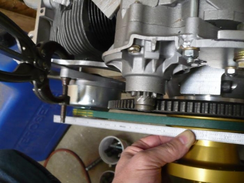

Added shims of .115" to get the belt parallel. Machined up a washer/spacer with a .421" hole through. Made a quick sholder bolt with shrink wrap on a 3/8" bolt. I will machine up a proper shoulder bolt later.
Pointed off bolt to mark location of upper bolt hole from right upper head.

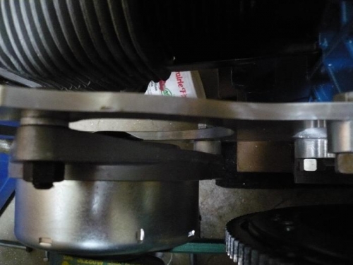

Drilled that hole in bracket and made 1.25" spacer from 3/4" 6061-T6 bar stock with 5/16 thru hole.
Cut adjusting slot and made .385" spacer for there also with a 5/16" hole for a 10mm bolt.
I might tack weld these spacers to the alternator and bracket so they don't get lost.
.115
.115" on the pivot boss
