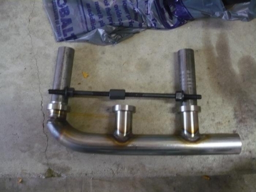

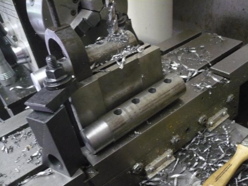

Cut and turned the left over 1.25" dia. bar stock. I think I can make a jack arrangement between the two bars and get the stretch back in the manifold.
Drilled .375" dia holes every one inch above the flanges. I can put a bunch of screws in if I need to.

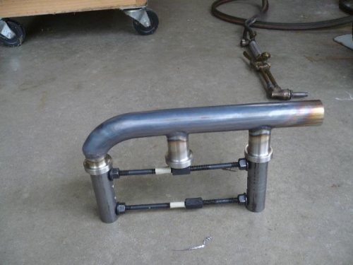

Two screws seems to be enough to keep everything inline and have enough pressure to heat the pipe back up.
Under pressure and heated
