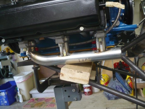

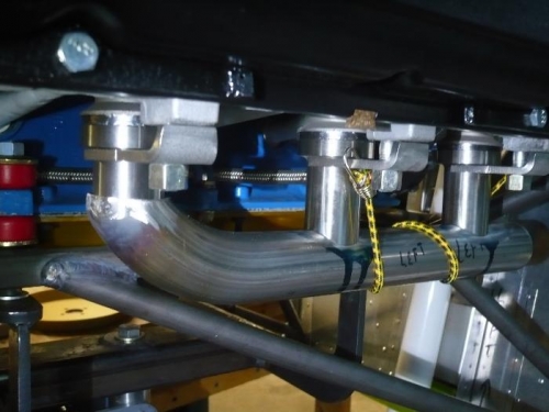

Tack exhaust manifold tube to stubs
Used the steel plug to smooth up the transistion with small finishing hammer.
Got everything fit and used wood to wedge this tightly in place, no bungee cord for tack welding.
Cleaned off the bluing, reset everything and tightened up the stubs. Checked with mirror and light to see the back side.
Got three good tacks around each stub.

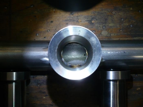

After purge welding I plan to machine through the stub ID to clean up the air flow.
Fitting done
Ready to purge weld
Looking inside the stub
