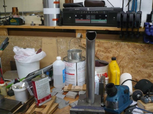

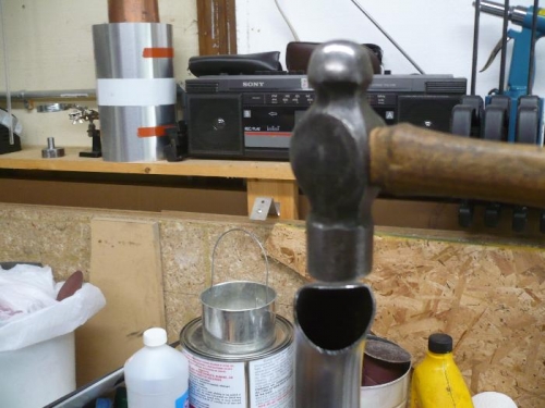

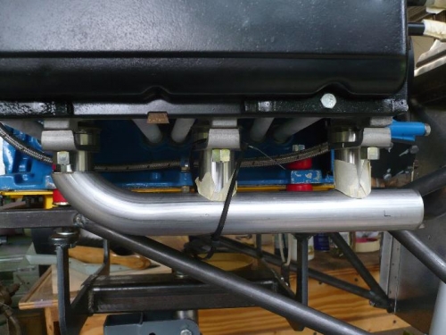

Brief Description:  Fabricate exhaust
Cutting a diagonal makes for an open transistion. Supporting the pipe on its end off the vice and a few wacks with the hammer close up the area and the rest will form in after the tack welding begins. Using a little heat should help shrink the metal around the stub.
Solid base
Solid base
Solid hits
Solid hits
No play fore and aft
