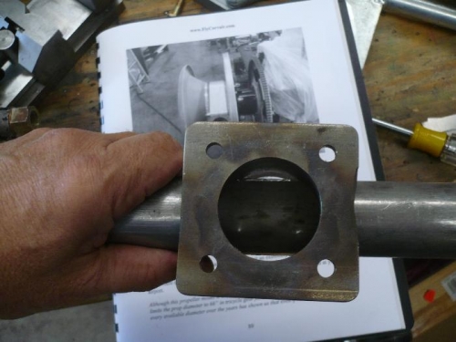

After roughing on the mill I used the cutoff wheel on the dremel tool to get closer to the line.

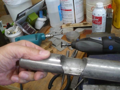

I placed marks on both tubes so I could align them back to the same place after cutting out the inside of the transistion piece.

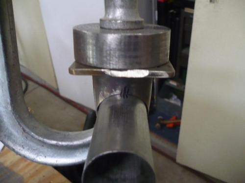

Lined marks up, clamped and taped ends to purge argon inside while welding.
