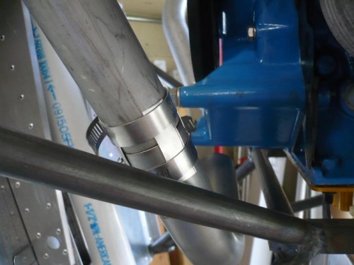

Brief Description:  Intake Fabrication

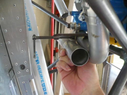

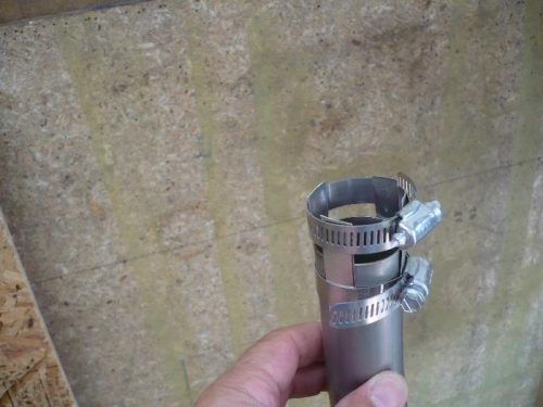

Here is a way to hold tubes together and be able to tack weld while its clamped. For initial fitting only one side is tight, that allows you to move and remove while fitting the ends.
It allows you to free you hands to see how things are going to fit.
Here I determine the cut line through the bend off the end of the straight pipe.
