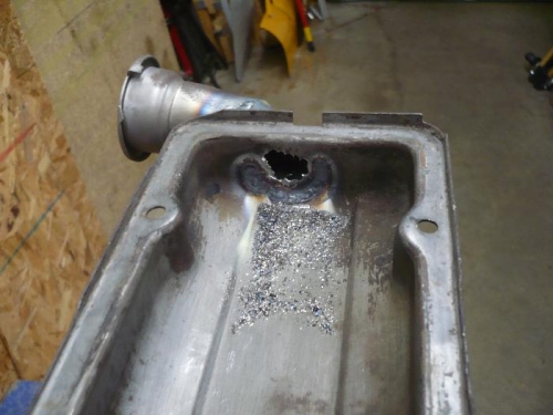

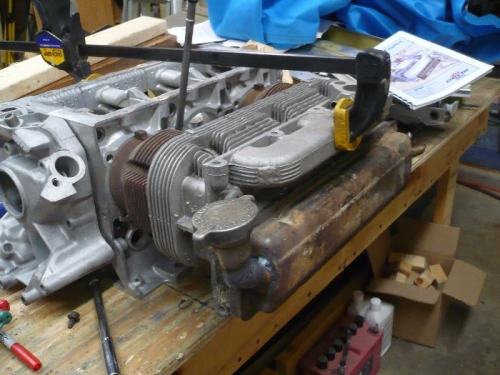

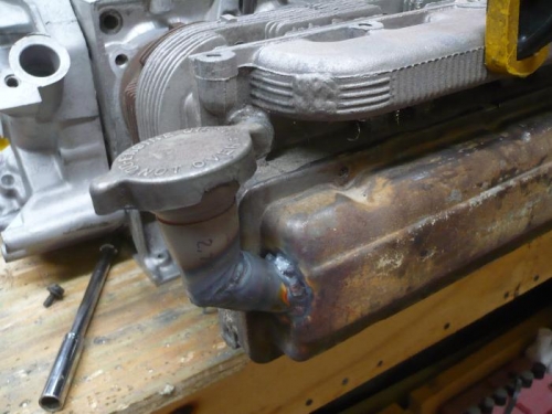

Brief Description:  Right Valve Cover mods, oil fill
Used tube cutter and cut length 2.75" from the cap end, without the cap. Ground angles on the remaining pieces then tack welded it into position. Welded all I could reach then opened the hole on the inside close to the id of the pipe then compled joing the welds from the inside.
