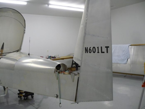

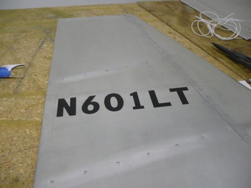

Adding the tail numbers

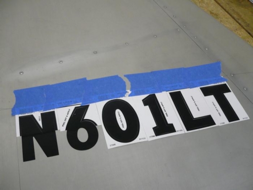

Clean the area with lacqurer thinner.
Tape the numbers to the line, peel half the backing and cut away, let the numbers down to the clean surface gently and press in place. Remove the tape and the top backing, and let the numbers fall gently in place, press in place.
