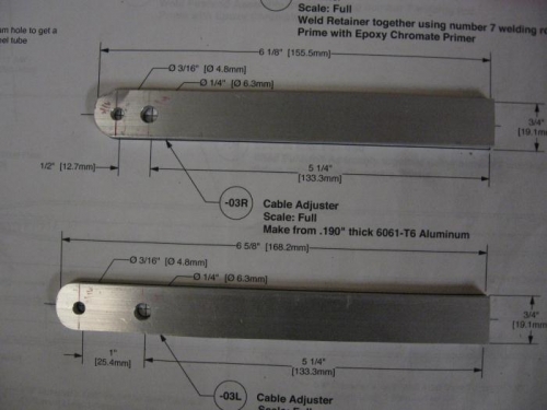

Brief Description:  Rudder Cable Adjusters
Made the cable adjusters from thick (0.19") 6061-T6 metal stock. There was nothing hard about this, but shaping the rounded ends just right took quite a bit of time. I could have used files, but being lazy I just spent a lot of time on the Scotch-Brite wheel shaping them.
