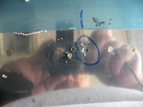

When I checked the right tank back back on January 18, I found one leaking rivet about mid-span on the top side of the skin to baffle joint. The leak was out of the rivet head, but NOT the shop head or joint. Today I took advantage of the spring-like weather to take a first shot at repair. I drilled out the offending rivet, cleaned the sealant from top and bottom of the hole, and replaced the rivet. I dabbed a bit of sealant in the hole and dipped the new rivet in sealant before setting. I then cleaned the excess sealant from around the top side of the hole and re-encapsulated the shop head. I'll let this cure at least a week before retesting.
For future reference, the offending rivet was very nearly aligned spanwise with the 15th screw hole counting from the inboard end.

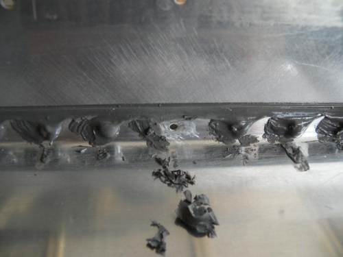

The offending rivet drilled out and cleaned the countersink with MEK.
I scraped the sealant away from the bottom side, then cleaned the area with MEK.
