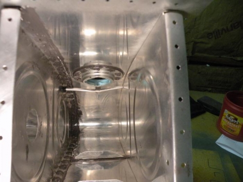

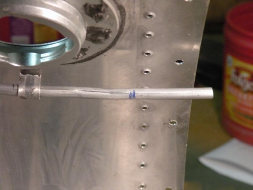

Tonight I fit the vent line to the right fuel tank. I made the initial cut a couple of inches long so I could trim to fit. First, I flared the inboard end, then bent it to mate with the fitting. I then marked and trimmed the outboard end so it would be as far outboard and as high as possible. It took about three times trimming to get it where I wanted it.
