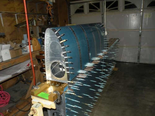

Sealed and riveted the remaining four interior ribs, including fillets and encapslulating rivet heads. Clecoed baffle in place to pull skin into postion and mounted the tank on the wing. It will be at least Wednesday before I continue work.

The five interior ribs sealed and riveted.
