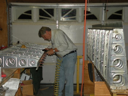

Tonight I riveted the rear spar to the right wing skeleton. After having to drill out four rivets when riveting the rear spar on the left skeleton (6/1/12), I was careful this time to mark holes that get riveted later in assembly with other parts, and even marked the rivet sizes on the rear spar. The problem was that I did all that on the spar... and inserted rivets from the rib side. I managed to rivet one hole that I shouldn't have (when moving from a rib that gets riveted with the aileron gap seal to a rib that gets riveted with the flap brace). I also managed to pick a -4 where a -6 should have gone. Oh well, only two drill-outs on this rear spar. I guess maybe a couple more RV's and I'll have it down...
After riveting the rear spar, I had Karen help me take the spar crate to the back porch, and stood the skins crate on end to make more room in the shop.

Riveting rear spar.
Riveting rear spar.
Skeleton on the stands, and shop rearranged slightly.
