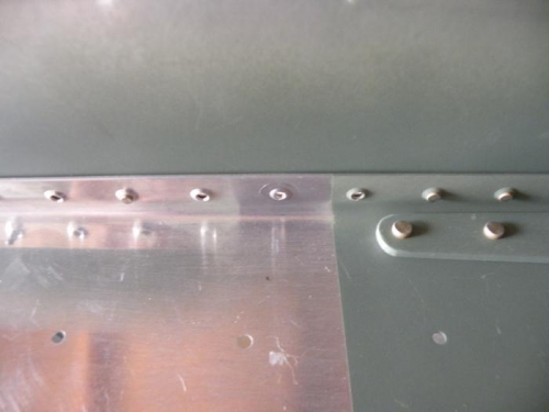

I was about to call it good when I noticed that I hadn't dimpled the top side of rib #7, counting from inboard. I quick grabbed the squeezer and took care of that little detail. I'm waaaay glad I found it before starting riveting! I took a little extra time and put a finger on every hole to ensure that I hadn't missed any other dimples.
(Edit 9/23/12: despite my best efforts, I still managed to miss dimpling the second hole outboard of the reinforcement bars on the top side of the rear spar flange prior to riveting main top skins. I took care of that with the tools in photo1, with the results in photo 2. The rivet came out nice and flush, and there's no gap between the skin and spar flange.)
Tools to fix the missed dimple.
Corrected dimple in the center of the photo.
