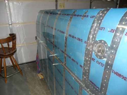

Brief Description:  Left Leading Edge Complete

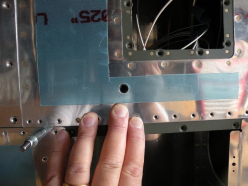

I forgot to enlarge the tiedown hole before riveting the leading edge ribs to the spar yesterday. I checked the pilot hole with a drill bit, and it appeared to center in the tiedown hole. After drilling to 3/8" with a unibit, it appears to be right on. I was able to pull the skin out far enough that to prevent drilling into the tiedown bar. I only had to blow out the chips to make it ready for the tiedown ring.
I then riveted the leading edge skin to the spar - very straight forward. The only thing to remember here is the half size longer rivets where the main rib flanges intersect the spar flange.

Drilled the tiedown hole in the bottom of the leading edge skin; better late than never...

Done!
