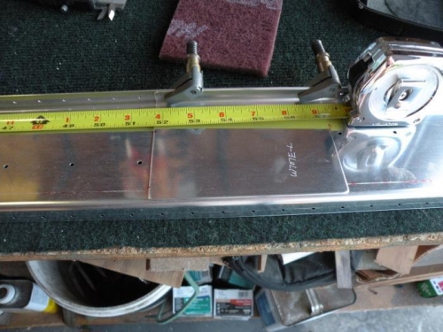

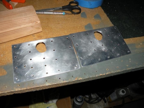

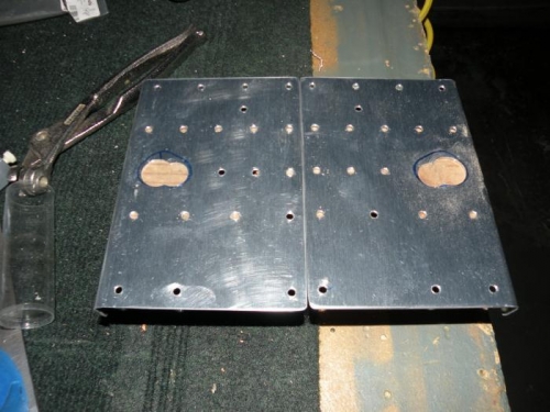

Brief Description:  Drilled Aileron Bracket Reinforcement Plates
Located, drilled, and deburred both aileron bracket reinforcement plates, including the pushrod clearance hole. I used a unibit do remove most of the material from the pushrod hole, followed by my die grinder, files, 100 grit sandpaper, and maroon scotchbrite.
Locating the inboard aileron bracket reinforcement on the left rear spar.
Most of the material remove with a unibit.
Done
Done
